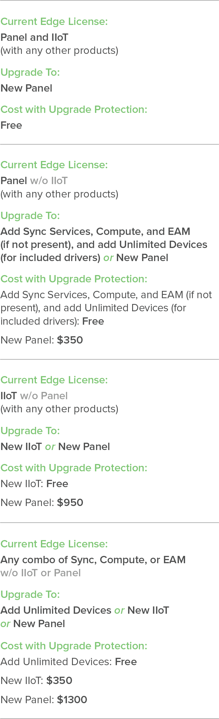

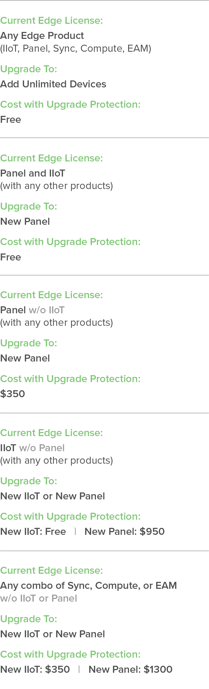

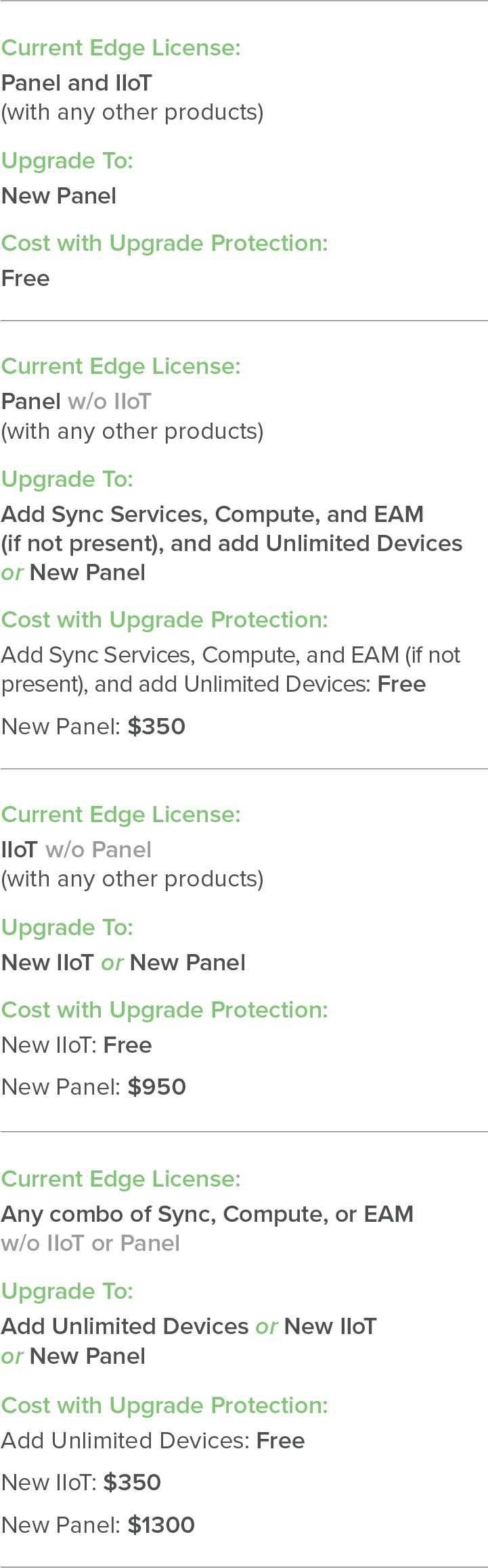

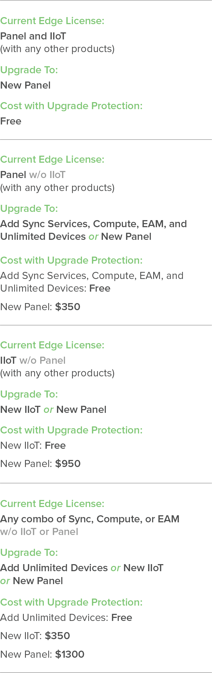

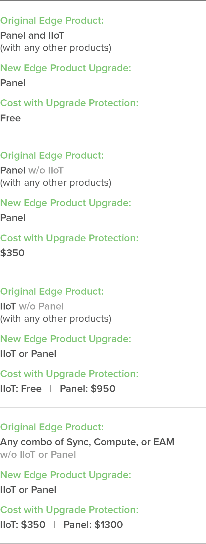

If you have an existing Ignition Edge license with Upgrade Protection, there are some free and automatic upgrades available for your license, as well as some optional upgrades for purchase. Free upgrades are automatically applied to licenses that qualify (just refresh your license). Check out the table below to see the upgrade scenarios for Ignition Edge with Upgrade Protection.
Current Edge License
Upgrade To
Cost with Upgrade Protection
Panel and IIoT
(with any other products)
New Panel
Free
Add Sync Services, Compute, and EAM (if not present), and add Unlimited Devices (for included drivers)
Free
Panel w/o IIoT
New Panel
$350
New IIoT
Free
IIoT w/o Panel
New Panel
$950
Add Unlimited Devices
Free
Any combo of Sync Services, Compute or EAM w/o IIoT
or Panel
New IIoT
$350
New Panel
$1300
